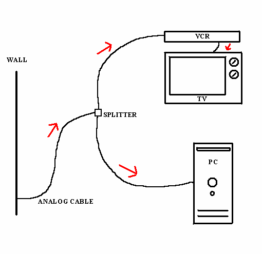

attachment.php
This is my set up and has been for years. Analog cable coming from the wall in my room (originally from the basement). The cable goes into a splitter: one way to my VCR (to use as a converter [old knob TV] and recorder), other way into the back of my PC, into the TV Wonder Pro card. With this set up, I can watch TV through both TV and computer, and can watch/record different things on different screens. Example, I could be watching something on channel 25 on the television and be watching channel 50 through the ATI TV on the computer monitor. I can change channels separately on the computer using the ATI TV.
For those of you who live in Ontario, Canada, and are with Rogers Cable, then you know that starting back in January 2012 there was an announcement that Rogers was shutting down its analog cable and that people still with analog would need a digital box to keep getting channels. This started in the biggest cities in Feb/Mar, and just today (which prompted me to come back and post here) I got a letter from Rogers for my area (a smaller district about an hour and half south of Toronto) that we need these boxes soon as by May 31, 2012 our analog service gets shut down. From what I’ve read here, and from what I’ve read in general about digital cable, boxes, and PVRs, this essentially makes my current set up useless.
Everything has to go through the digital box first. Gone are the days of spitting analog cable as much as you wanted to throughout your household (and subsequently paying for only one TV). Because you need a digital box for every television set you own. All of which cost more money/fees and drain more electricity as they are always on. The digital box becomes the primary source of function and the main thing to navigate channels. You can only change channels through the box! This means I can’t change channels through the ATI TV anymore, because its source to my computer is an analog source that never needed a digital box to convert anything first. After May 31, 2012, I assume I will only get white noise or nothing through my ATI TV.
And even if I got a digital box, and then spilt it on its way out (if that’s possible, I don’t know the detailed specifics about digital cable/boxes/PVRs or even DVD recorders) two ways to my old television set and to my computer…I’d assume that since you can only change channels through the box, what I watch on my old TV is what I will see through my computer. I won’t be able to watch different channels at once anymore. Hell, I don’t even know where the digital cable signal would even show up on ATI TV if I spilt it from the digital box and hooked it to the TV Wonder Pro card on the back of my PC. Channel 3? Channel 4? Auxiliary video? As per what I’ve read as a whole on digital cable – we’ve lost the ability to simply record one program and watch another. That’s what the VCR was all about in the 1980s! That seems like a major step back and I don’t even know if you can hook a VCR up to a digital box. How can you watch one thing and record another if all functions go through the digital box and not the VCR? I assume the one free box you get from Rogers only has one tuner inside of it.
