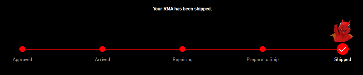

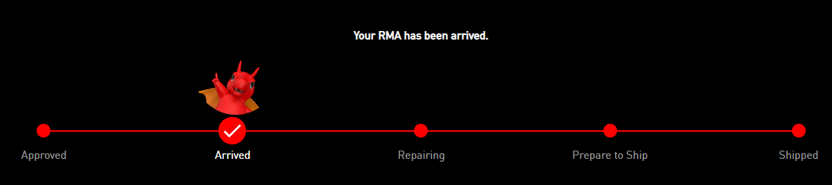

                                                    Eight days from the initial request, I get an approved RMA number for it. I ignore the new RMA#, and will continue to do so.

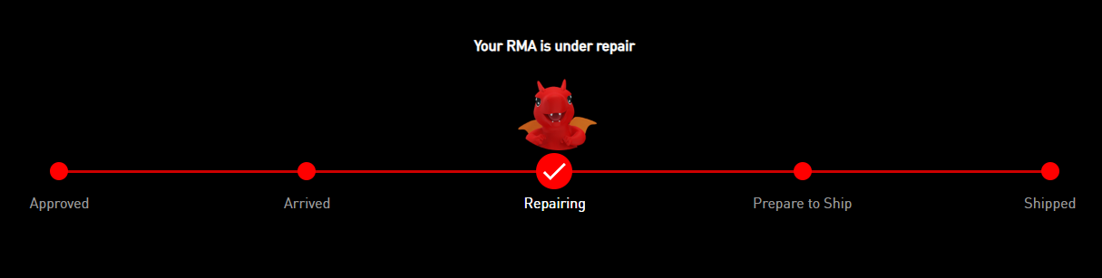

                                                    MSI says they have received it.
                                                    MSI says they are working on it.
                                                    Please fix this thing guys.

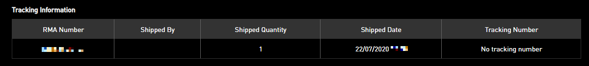

                                                      Seems like good news, except no tracking information:
                                                      (RMA number and ship time edited because it seems like the right thing to do in this day of bots)
                                                      Also no feedback. No emails. Nothing stating they found something or they did not find something. So far, only about 50% as bad as the experience could possibly be. If they actually fixed the card, everything is roses. If the card is not fixed, I am boycotting MSI.
                                                      Late edit: have tracking info now. Should arrive Tues.

                                                        #28
                                                        7970 basically folded the entire time the Vega was gone. Not a single crash.
                                                        Vega arrived this morning.

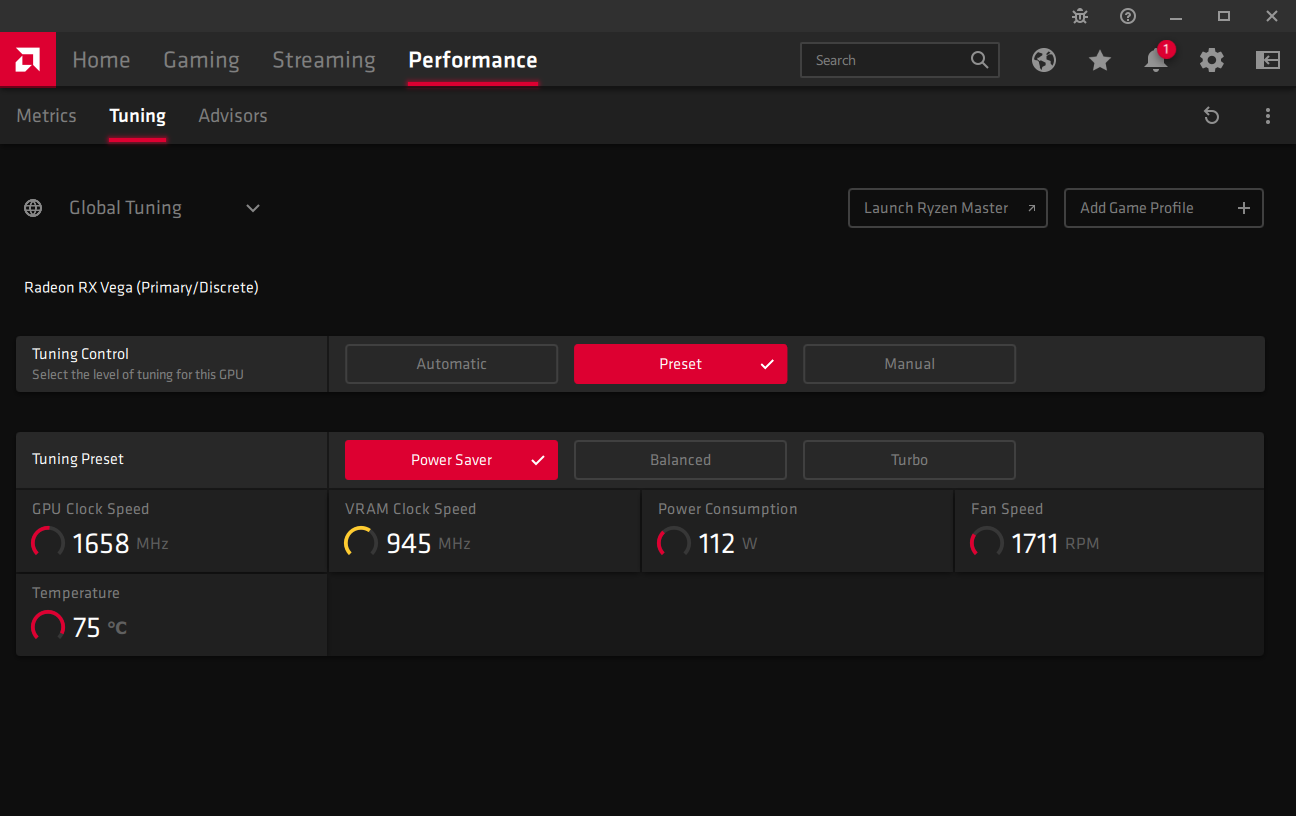

                                                        Did all necessary steps to uninstall drivers, put Vega back in, reinstalled drivers. Ran 3DMark. Not as high scoring as previous runs but new drivers whatever.
                                                        Left all settings at default.
                                                        Started folding. Two "fan at 100%" crashes in 5 hours.

                                                              This is the 2nd GPU I've had with their brand on it and the 2nd GPU that has been jacked up in my lifetime of owning GPUs. Previous was MSI X800 Pro with artifacting straight out of the box.
                                                              I have an MSI laptop. It works great. I have had three MSI motherboards. They are great as well. No more MSI GPUs for me.
                                                              This really sucks. Do you have any other recourse to get the card fixed?
                                                                #32
                                                                I've read a few threads/reddit posts that say after you've RMA'd the same card three times they replace it, or you get a credit or refund for the purchase price. For me that would be $280 because I redeemed the three games from the promotion at the time, effectively subtracting $150 from my $430 purchase price. Considering 3 shipping purchases at $30, I come out with $190 and ~three months of using my 7970 instead (which is on its last leg).
                                                                Other than that, my only recourse is to get screwed.

                                                                  How much power is it drawing/how hot is it getting when folding? It sucks that there seems to be something wrong with the card, but maybe it's worth trying to get to the bottom of what the problem is.
                                                                  You could install MSI Afterburner and trying bumping the core and memory clock down a little, and/or reduce the power limit (do them one at a time), and see if you can figure out what the issue is. That may help get it resolved, or at least provide a work around.
                                                                  Anyway, this sort of thing really sucks. I had a Gigabyte X370 motherboard that suffered from the "soft brick" bug (basically sometimes when powered off the board just wouldn't boot as if it were dead, but pulling the battery fixed it). It was so bad that it was happening multiple times every week, so I tried to RMA it but it wasn't fixed. I eventually just gave the board away to a friend as there wasn't any way to get it fixed properly, and I couldn't sell it to anyone in good conscience with that problem. You definitely have my sympathies dealing with a troublesome RMA situation.
                                                                    #34
                                                                    I've changed numerous settings, and different WUs cause different power load. For instance, the one that I'm crunching now on Power Saver preset was resumed from a crash overnight. It's drawing a meager 115W at peak.
                                                                    I've fiddled with core voltages, clock settings, and aggressive fan ramp-up. None of it seems to matter.
                                                                    The one time (before RMA) that it ran for days without a crash was when I used the Turbo Preset (Vega has Power Saver, Balanced, and Turbo Presets in addition to the Auto/Manual tabs) (screenshot), at 82C average GPU temp and average 240W power draw. But then randomly went back to crashing every few hours.
                                                                    I ran/folded with my HD 7970 at (guestimate) 180W continuously for over a month without a single crash. It was awesome in that respect.
                                                                    I'm tempted to pick up a $280 5600XT at a ~15% performance loss and be done with it.
