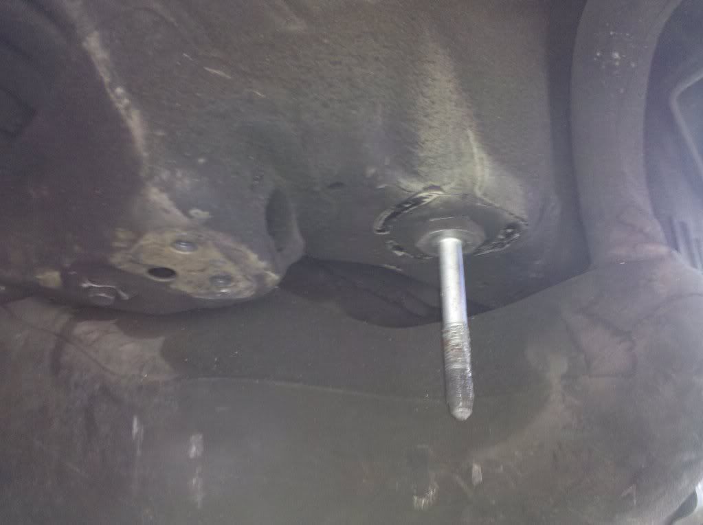

                                                              That's an 8" wide hole.
                                                              That's the mount diagonal to the 8" wide hole, breaking as well. Only 2 mounts solidly held the rear subframe in, the other 2 were ruined. The damage is 5-7k worth of damage to fix properly, car is only worth 6-7k in mint condish.
                                                              The whole piece of sheet metal(seen here, from another car who had a similar tear)
                                                              Is actually trying to tear itself out of the car, it's literally coming unwelded. I've never tracked the car, it was almost entirely stock, suspension wise for the majority of the time I owned the car.

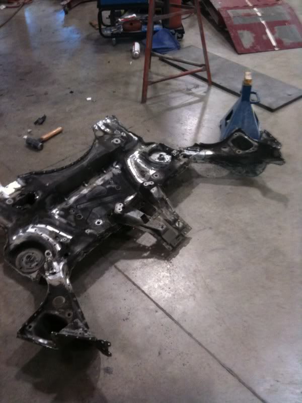

                                                                          Got the rear subframe out of the E30 and did some measuring. The E24 subframe I got would fit under the E30 no sweat, like you said, the mounts are about half an inch apart. The only thing I have to do to fit it is grind down the bead along the side of the subframe by the mounts on each side, and only a tiny bit of it would need to come off. Probably would patch it up with a weld, so it doesn't cause an issue structurally... I'm concerned about the spot where the shock/spring mounts on the E24... With the E30, the shock mounts below the axle, on the E24, it mounts directly above the axle, so I'm concerned it's going to cause some headache when I get the subframe mounted in the car. I also measured how far from the subframe mount the rear wheel was on the E24 rear end versus the E30, and it'd move the wheel rearwards about 1/4", maybe slightly less, so I don't think that's an area of much concern.
